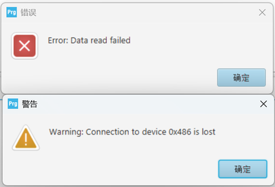

After connected, I choose the "ai_fsbl.hex" file, and clicked "start programming".Then the connection is disabled, with 2 messages saying "connections to device 0x486 is lost" and "failed to download files".

16:51:32 : Warning: Connection to device 0x486 is lost
16:51:32 : Disconnected from device.After the disconnection, I can't connect the board to the CubeProgrammer again until I unplug the wire connecting the board with my laptop and then plug it back. Same error messages show every time when I try to connect the board again.

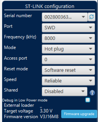

1. The ST-LINK configuration is shown below:
I've tried changing some of the configuration like "Frequency", "Mode", "Reset mode", but it doesn't work, the same messages still show.

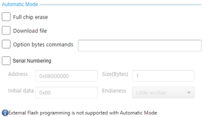

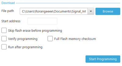

2. The programming configurations are shown below:
I've also tried several different settings, but it still didn't work.

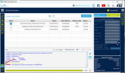

I found the point. I should select the External Loader.
Here's the solution:
Click the "EL" button left-bottom, and search the "STM32N657", select the one with NUCLEO(according to board maybe), and repower and reconnect it. Then the file should be downloaded successfully (at least mine is downloaded now).

You can also try to select the External loader in CubeProgrammer:
