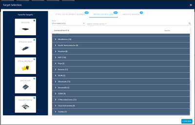

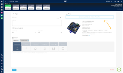

Hello @ChristianValota,
What Microcontroller are you using?
You need to look in Project Settings (first step) if you can find it as a target:
- Click on target:
- Go the the microcontroller tab:
@Chris21, thank you for your answer. At the beginning, NanoEdge was indeed only for STM32. It has been decided to expend the list of compatible board. The only difference is that for STM32, the use of NanoEdge for production is also free, whereas for other brands of microcontrollers, we (in theory) will ask for royalties.
Have a good day,
Julian
