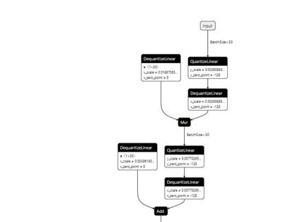

Note that because your model is very small, the quantization makes it bigger (5.7kiB to 7.9kiB).
It adds quantize and dequantized nodes everywhere, but the benefit of quantizing your weights to int8 is smaller that the drawback of adding these nodes:
I would advise you to test both your quantized and non quantized models on the benchmarking tool to see which one is better for you in terms of execution time and memory footprint.
It should be similar I think, so maybe, not quantizing is maybe better as you will not loose accuracy because of the quantization.

Yes, in order to visualize the accuracy decrease, you need to download the tflite model (at the bottom of the quantization step, you can get the tflite model). Then you can look on google how to use the tensorflowlite library in python to do inference.
In your case, as we discussed, you model is increasing in size and inference time because of the quantize/dequantize layers, so I would not quantize it. It also removes the impact on the accuracy for the quantization.
There is still a possible variation in accuracy because of the conversion to C code as python and C layers are not bits to bits exact.
