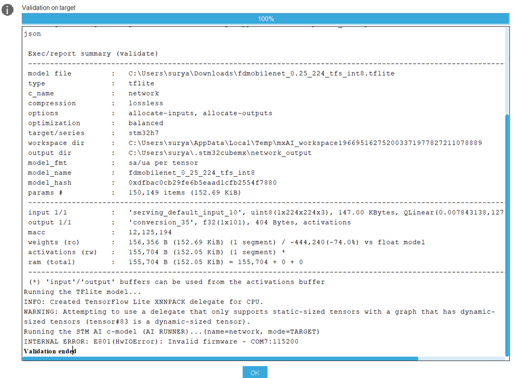

It is fine until validation on desktop... But when it comes to validation on target, the above shown error is displaying...
Can anyone please help me with this error... I am trying this since 3 months...

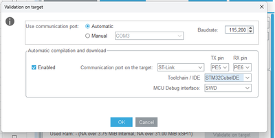

Hello @Pinagadi_Meghana ,
Indeed, you need to enable to enable the "Automatic compilation and download" to flash the validation firmware in the N6 for the validation on target to work.
In my case, I am using STM32CubeIDE:
