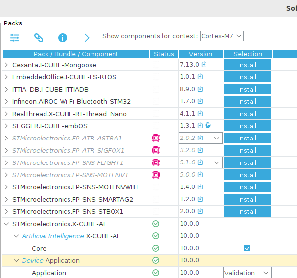

I confirm that I've enabled the Cube AI for the M7, it is set as in this image:

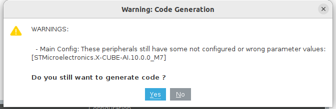

I can generate the project, even if I get this warning
however, it is missing something. If I try to compile the project for the M7 I get this output:

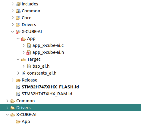

"make -j16 all" terminated with exit code 2. Build might be incomplete.and I can see that there is no directory called "Middleware" as in other generated projects. This is part of the directory tree that shows the content of the X-CUBE-AI directories:
