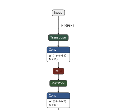

I'm trying to deploy a model on the boards of the dev cloud, the initial layers are these:
however, when it comes to the quantization steps if I add an npz file for validation I receive this error:
[ONNXRuntimeError] : 2 : INVALID_ARGUMENT : Invalid rank for input: input Got: 2 Expected: 3 Please fix either the inputs or the model.

2025-03-27 6:30 AM - edited 2025-03-27 6:30 AM
Hello @Dresult ,
Can you send the model, I think that if you do a stedgeai generate, it is written somewhere, I would like to verify that.
Can you try to generate (batch_size,1,4096,1) and (batch_size,1,1)?
For example:
import numpy as np
x_test = np.random.rand(10,1, 4096, 1).astype(np.float32)
y_test = np.random.rand(10,1, 1).astype(np.float32)
np.savez("test_data.npz", x_test=x_test, y_test=y_test)
It is similar to this question: Solved: Error in Post-Training Quantization: 'Axis 2 is ou... - STMicroelectronics Community
I will need your model to know for sure.
Also the part about the idea that quantizing a small model can make it better may interest you
Have a good day,
Julian
2025-03-27 8:32 AM
Thank you very much! With this input shape it works perfectly, however I don't understand, I thought the first dimension was the batch size...
2025-03-28 5:49 AM
I think, to test your data, the code do something like: prediction = model(X_test[i]).
So in your first code, X_test[0] would be of shape (4096,1) and not (1,4096,1).
Have a good day,
Julian
