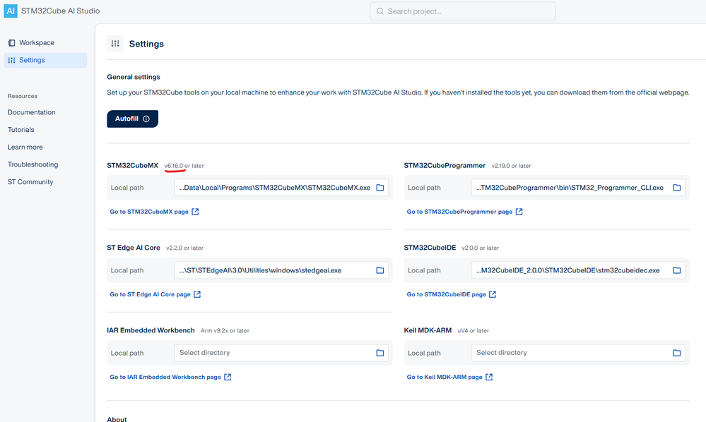

Hi @kloudy
Could you try to update your CubeMX please.
Minimum required is version 6.16.0 and CubeIDE to version 2.0.0
