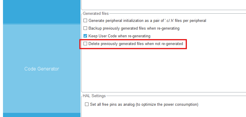

Hello @chanchal94 ,
When regenerating, please uncheck this box to see if it corrects your issue
Best regards,
Yanis
2026-03-02 9:11 PM - edited 2026-03-03 3:22 AM
I tried unchecking the box as suggested by you, @hamitiya, but the issue still persists. The problem remains the same — corrupted files and the path issue that I explained earlier in detail.
This is the error that is coming during build:
Description Resource Path Location Type make: *** No rule to make target 'C:/Users/hp/.stm32cubeaistudio/workspace/Modified_STM32/Middlewares/ST/AI/Npu/ecloader.c', needed by 'Middlewares/ST/AI/Npu/ecloader.o'. Stop. Modified_STM32_Appli C/C++ Problem
