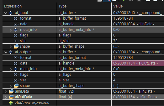

}I have checked the 'ai_input' and 'ai_output' values and they all pointed well.
