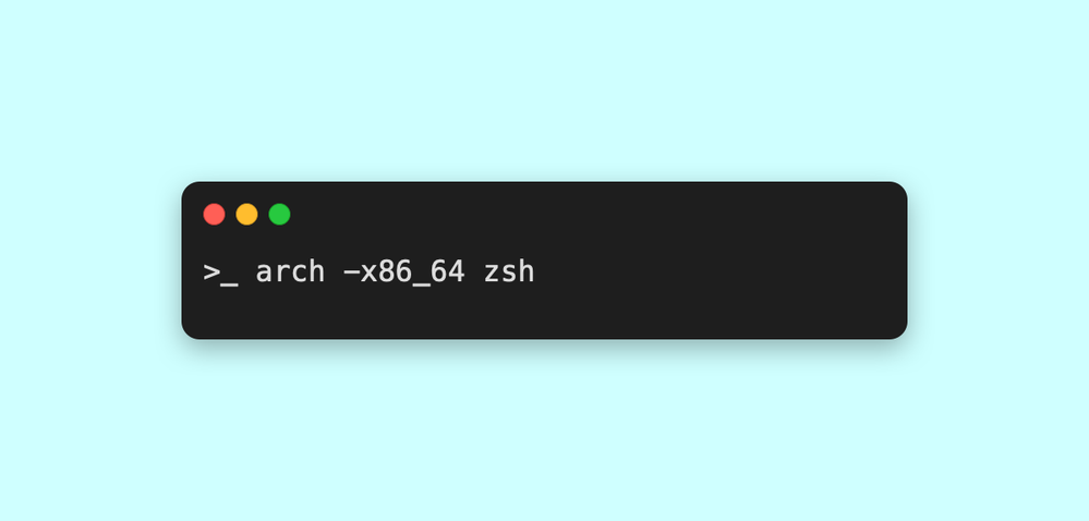

Unfortunately M1 macs are currently not natively supported, but did you try to enable Rosetta 2 compatibility mode ?
You can try the answer used for "nvm" from this thread: https://github.com/nvm-sh/nvm/issues/2350#issuecomment-734132550
Then try starting the stm32ai command line again from the terminal,
Hope it can help,
Romain

Dear Romain,
Thanks for your answer and possible solution. Unfortunately, I try it but fail. Maybe we need a new build one for M1 specifically or use windows instead.
Hope your team's new build for M1.
