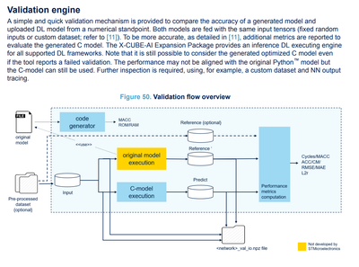

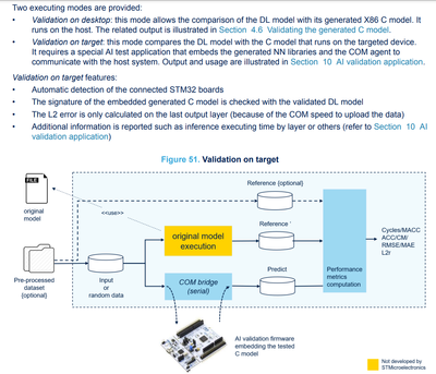

2025-01-06 5:31 AM
Hello @wypeng ,
I think the answer to your question is page 37&38 of this document:
It says that there are two causes of differences:
It leads in some cases to differences because the operations are not exactly the same.
So, to validate your model, you need to first make sure that you have a good accuracy when working in python and then deploy it and make new test to see the accuracy that you get.
Tests only in python are not enough.
If you see a significant accuracy drop using X-CUBE-AI then it may be an issue we have to work on. But seeing different is "normal".
Have a good day,
Julian
