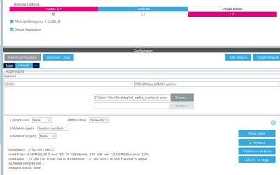

I am following this tutorial to use my own image recognition model with the STM32H747I-DISCO board. I have already ran the demos and they seem to work fine.
I first configure the model in CUBE-MX successfully and then copy the required files to the demo project.
When I compile the code in the STM-IDE I get the following error a bunch of times:
undefined reference to `forward_conv2d_if32of32wf32'
I also get this:
STM32H747I_DISCO_PersonDetect_Google_CM7.elf section `.bss' will not fit in region `DTCMRAM'
STM32H747I_DISCO_PersonDetect_Google_CM7.elf section `.axiram_section' will not fit in region `AXIRAM'
STM32H747I_DISCO_PersonDetect_Google_CM7.elf section `.sram_section' will not fit in region `SRAM123'
section .axiram_section VMA [24000000,241ad7ff] overlaps section .bss VMA [20017a40,2c6301a7]
even though CUBE-MX said that the used memory is within the flash and ram available (as shown in the image included).
The declaration is in layers_conv2d.h but I can't find the definition anywhere.
I have done the Updating to a newer version of X-CUBE-AI part in the tutorial successfully.
Any ideas?
thanks

Hello dogg,
The situation triggers me an idea.
Between the versions of X-CUBE-AI, the implementation of the AI kernels is continuously improving.
Your problem sounds like a misalignment between C, H, and lib files of X-CUBE-AI versions that you have inside your project. May be you have, during your exploration, ended to a situation where one file is from a different version.
I would erase all the X-CUBE-AI files from your project and redo the integration.
I hope it will help
With Kind Regards,
Nicolas_V

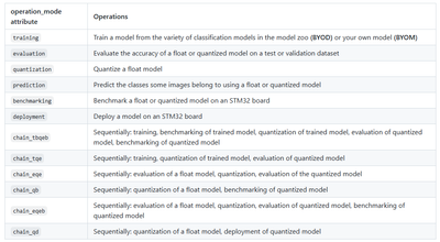

2024-11-07 5:25 AM
Hello @dogg ,
There are different operation mode, you used training that just retrain a model, here are all the operation modes:
https://github.com/STMicroelectronics/stm32ai-modelzoo/tree/main/image_classification
What I generally do is chain_tbqeb to do everything in one go: to train, benchmark the memory, inference time etc, quantize, evaluate the performance and do a new benchmark to see the difference between the .h5 and the .tfile.
You can use the quantize in your case.
For your first error, I am not sure what caused this, I never used the scripts other than the stm32ai_main.py
For the second error, it seems that a path is wrong and the file cannot be found.
The deployment operation mode generate a binary file flashed directly. If you want to generate a cubeIDE project or cubeMX project, you can take a look at the ST Edge AI Dev Cloud
https://wiki.st.com/stm32mcu/wiki/AI:Getting_started_with_STM32Cube.AI_Developer_Cloud
Have a good day,
Julian

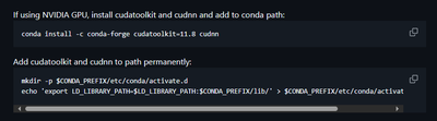

How can I use my nvidia gpu for the training with this script?
This is a bit confusing to me:
