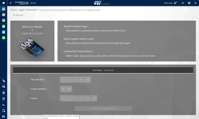

There is also a tool to generate data logging code using our Data logger generator tool directly in NanoEdge.
It is currently available on 2 ST development boards
You can select parameters and generate a .bin file to flash directly on the board and then log outputted data through serial in NanoEdge or tools like putty, tera term etc...
The frames parameters are the number of consecutive matrixes that you want to use.

When working with a ToF in NanoEdge, you will have to log data and here you have 2 choices:
