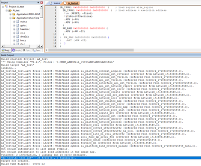

After I enable the CUBE-AI software pack(can't check the application),
and compiler the project, the error as below(there are 2 same RW_RAM):

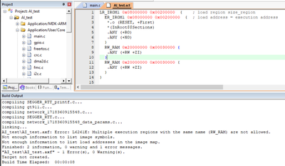

After commenting one RW_RAM and compiler again, the error was as follows:
I don't know what happened and how to resolve it, can someone help me?
Thanks for your help!

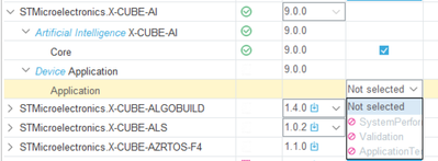

2024-06-14 4:55 AM
Could you be compiling the project without selecting the network?
You should choose a network trained with keras and let the cube ai tool create the necessary files.

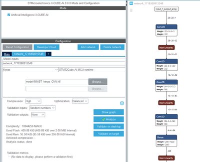

2024-06-14 10:34 AM
Thanks for your reply!
I already add the network in cubeMx:
The attachment is the analysis report, if you need to check it.
BTW, the network was downloaded from HERE.
