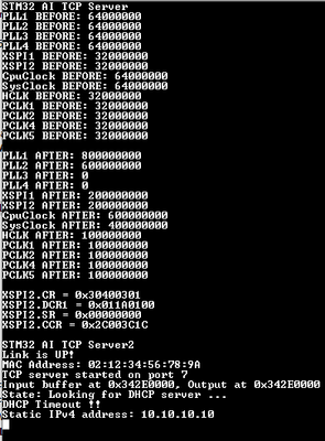

When I download and run the firmware from CubeIDE, everything works: the link comes up, and the neural‑network inference runs. When I boot from Flash, the code begins, prints the initial clock values and then halts. The same problem occurs without the use of lwIP, just by running the neural network.
For reference, the image below shows a complete successful log under CubeIDE:
While this image shows the output stopping before the new clock configuration values appear under flash boot:
