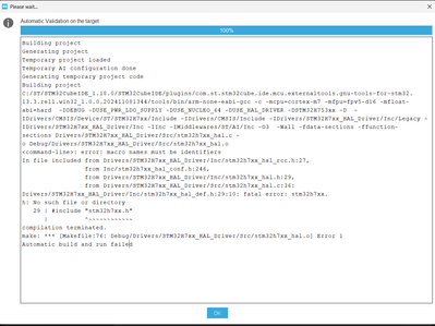

2025-03-13 2:59 AM
i got the same error.... what should i doo...
i didnt use any edge ai developer cloud... instead i did using mx... but the same error is displaying there...??
please help me through this...
