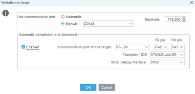

Hello. I have made with ST Edge AI Developer Cloud a model and downloaded the whole project for STM32CubeIDE.
When I do Validate on desktop it works fine and I get expected results.
But Validate on target gives me a compilation error.

Since you answered with STM32CubeIDE version, are you using STM32CubeMX embedded in STM32CubeIDE ? If yes, could you please install STM32CubeMX directly and try the same action with the standalone tool ? You can open the IOC file directly in STM32CubeMX.
STM32CubeMX - STM32Cube initialization code generator - STMicroelectronics
As @Tesla DeLorean said, it might be a include path or missing files. However, since it is from the automatic validation on target action, user does not have any action to do to include these files. We were aware of issues when code generation was performed with STM32CubeMX inside STM32CubeIDE, that's why my proposal is to perform it with the standalone tool.
As a second action, you could switch your application from "SystemPerformance" to "Validation", generate a project, compile/flash and do "Validation on target" without automatic compilation.

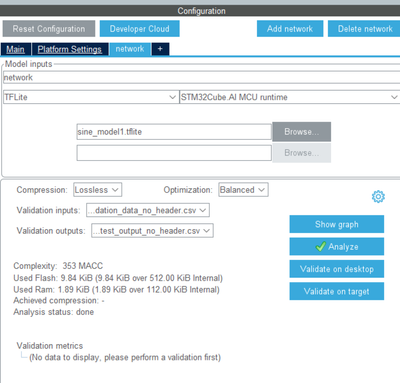

Hi again. Thanks for your input.
I tried it with latest MX version and there it compiles successfully.
Building project
Generating project
Temporary project loaded
Temporary AI configuration done
Generating temporary project code
Building project
Create.
Opening 'mxAI1071861028699'.
10:59:41 **** Build of configuration Debug for project mxAI1071861028699 ****
make -j16 all
arm-none-eabi-gcc -mcpu=cortex-m4 -g3 -DDEBUG -c -x assembler-with-cpp -MMD -MP -MF"Startup/startup_stm32g491retx.d" -MT"Startup/startup_stm32g491retx.o" --specs=nano.specs -mfpu=fpv4-sp-d16 -mfloat-abi=hard -mthumb -o "Startup/startup_stm32g491retx.o" "../Startup/startup_stm32g491retx.s"
arm-none-eabi-gcc "../Src/aiPbIO.c" -mcpu=cortex-m4 -std=gnu11 -g3 -DDEBUG -DUSE_HAL_DRIVER -DSTM32G491xx -c -I../Inc -I../Middlewares/ST/AI/Inc -I../Drivers/STM32G4xx_HAL_Driver/Inc -I../Drivers/STM32G4xx_HAL_Driver/Inc/Legacy -I../Drivers/CMSIS/Device/ST/STM32G4xx/Include -I../Drivers/CMSIS/Include -Os -ffunction-sections -fdata-sections -Wall -fstack-usage -fcyclomatic-complexity -MMD -MP -MF"Src/aiPbIO.d" -MT"Src/aiPbIO.o" --specs=nano.specs -mfpu=fpv4-sp-d16 -mfloat-abi=hard -mthumb -o "Src/aiPbIO.o"
arm-none-eabi-gcc "../Src/aiPbMemRWServices.c" -
continous compilation
Exec/report summary (validate)
model file : C:\Users\danne\OneDrive\Skrivbord\ai2\NUCLEO-G491RE\sine_model1.tflite
type : tflite
c_name : network
compression : lossless
options : allocate-inputs, allocate-outputs, multi-heaps
optimization : balanced
target/series : stm32g4
memory pool : C:\Users\danne\AppData\Local\Temp\mxAI_workspace11729533689007102031768400636249\mempools.json
workspace dir : C:\Users\danne\AppData\Local\Temp\mxAI_workspace11729533689007102031768400636249
output dir : C:\Users\danne\.stm32cubemx\network_output
vinput files : C:\Users\danne\OneDrive\Dokument\validation_data_no_header.csv
vinput files : C:\Users\danne\OneDrive\Dokument\y_test_output_no_header.csv
voutput files : C:\Users\danne\OneDrive\Dokument\y_test_output_no_header.csv
model_fmt : float
model_name : sine_model1
model_hash : 0xcbda45f1585bf3d837013bae283118d6
params # : 321 items (1.25 KiB)
input 1/1 : 'serving_default_keras_tensor_80', f32(1x1), 4 Bytes, activations
output 1/1 : 'gemm_2', f32(1x1), 4 Bytes, activations
macc : 353
weights (ro) : 1,284 B (1.25 KiB) (1 segment)
activations (rw) : 128 B (128 B) (1 segment) *
ram (total) : 128 B (128 B) = 128 + 0 + 0
(*) 'input'/'output' buffers can be used from the activations buffer
Memory-pools summary (activations/ domain)
name id used buffer#
POOL_0_RAM 0 128 B (0.1%) 6
weights_array 1 1.25 KiB (128400.0%) 6
Running the TFlite model...
INFO: Created TensorFlow Lite XNNPACK delegate for CPU.
Running the STM AI c-model (AI RUNNER)...(name=network, mode=TARGET)
STM Proto-buffer protocol 3.1 (SERIAL:COM3:115200:connected) ['network']
Summary 'network' - ['network']
inputs/ouputs : 1/1
input_1 : f32[1,1,1,1], 4 Bytes, activations
output_1 : f32[1,1,1,1], 4 Bytes, activations
n_nodes : 5
compile_datetime : Nov 7 2024 10:59:46
activations : 128
weights : 1284
macc : 353
tools : Legacy ST.AI 1.0.0 - Proto Buffer msg v3.1
runtime lib : 9.1.0 compiled with GCC 11.3.1
capabilities : IO_ONLY, PER_LAYER, PER_LAYER_WITH_DATA
device : stm32 family - 0x479 - STM32G491 @170/170MHz
fpu
INTERNAL ERROR: E801(HwIOError): Invalid state: 4 instead 1
Validation ended
The warnings are about _close, _fstat, _isatty, _kill aren’t implemented.
I get INTERNAL ERROR which I don't understand, so still, Validate on target has problems.
