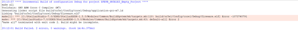

我能为此问题做些什么
似乎系统无法使用 SDKS 文件夹中的工具
Translation:
"What can I do with this problem? It seems that the system cannot use the tools in the SDKS folder"
2025-04-24 2:08 AM
Hello ,
Could you try by using StellarESDK-1.8.0
I advice you to enable the Verbose mode in your Makefile to understand what happened ?
Could you install a terminal like git-bash in your windows and launch open a terminal in the directory.
Best regards
Erwan
