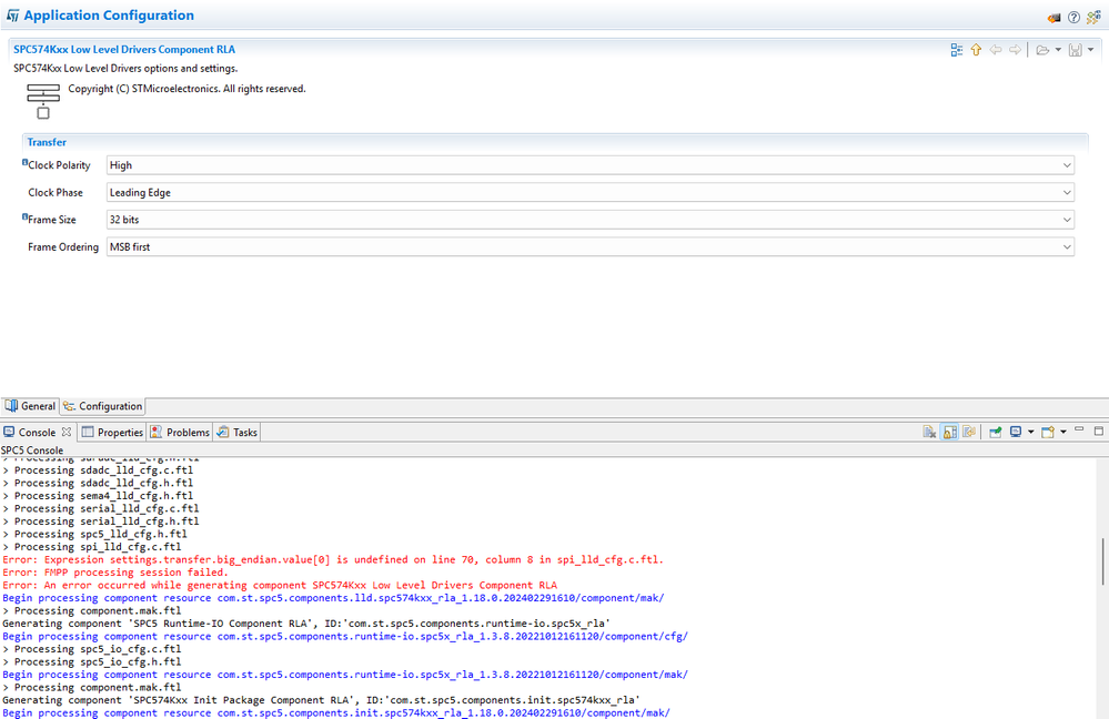

Hallo,
I tried to use the DSPI_0 interface with the transfer configuration as shown in the picture, but cannot generate the necessary code with the error shown below. I could try a walkaround with byte wise frames and exchanging 4 bytes at a time but I would rather use the correct frame size.
I hope someone can help me.
Generation Error
