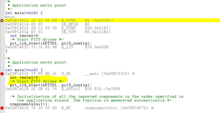

I'm loading aplication's SPC58EC DISP, and debugging, but if I change the main.c this is the 9 problens. What it's, please?
Another problem is that if I change and build the project, the changes not appear
in the UDESTARTERKIT.

2020-10-07 8:58 AM
I only had created one variable in main.c
If i change anyfing in main.c have 9 problens.
We see that the project folder is only read.
If I uncheck box read only in the folder , after building it's return to read only.

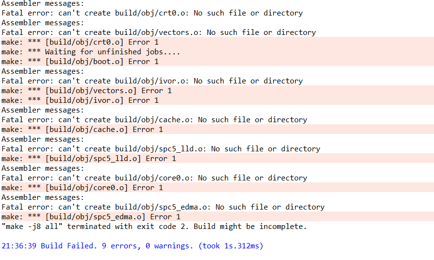

2020-10-13 2:32 AM
Hello ,
The problem can come from CDT. (C/C++ Development Tooling) Symbol Issues on the compiler.
could you send me the screenshot ?
could you detail your issue and show the errors logs ?
Best regards
Erwan
2020-10-13 3:58 AM
below it's 9 problens,
If I change the main.c and build the sisten not such the directory,
I see again if only write in the main one variable for example:
the SPC5studio don't creat the code.
2020-10-16 2:39 AM
Hello ,
Ok , i see your error logs ;)
Have you clicked on generate before compilation ?
could you export and send me your application if there is no confidential code?
What is your installation details ?
Best regards
