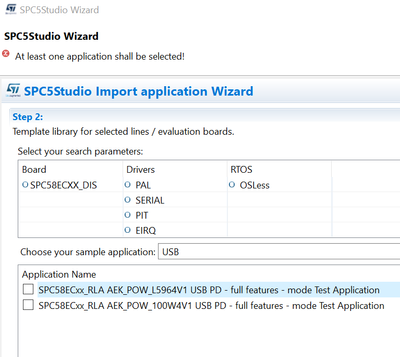

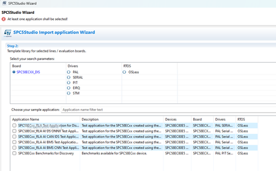

For the management of the power board, you have to import sample from application library in AutoDevKit Studio (www.st.com/autodevkitsw:(

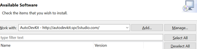

AS of the above response I couldn't able to import the Application wizard of the Power Board ( SPC58ECxx_RLA AEK_POW_100W4v1 USB PD ). Below is the screenshot for your reference.

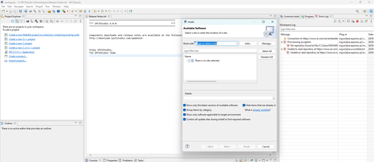

Also, while I'm trying to install AutoDevkit software inside SPC5Studio, Im getting this type of error.
As according to my understanding, below is the flow I am following to implement USB PD application.
1. Install SPC5Studio software.
2. Install AutoDevkit software library which should support SPC5Studio in implementing applications.
3. Build an application according to the requirement ( or importing already available application which can be imported from the library ).
4. Once, WSX file is generated after compiling the code, it will be opened in UDE Debugger software for debugging.
5. Once the final firmware is ready, then it can be flashed into flash memory of the controller.
6. Interface the board and it is ready to use.
Please correct me if I'm wrong.
Presently, I am stuck up in the 2nd step. This may help you in providing better solution.

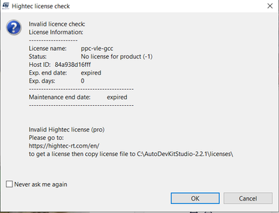

Also, we are facing Invalid License issue with AutoDevkitsudio . We have pasted license in the path as mentioned in the instruction but still we are getting error.
Thanks in advance.
Suvo
2024-04-24 6:08 AM
The instruction you are following are outdated.
You do not need to install SPC5Studio.
Just install directly AutoDevKit Studio from www.st.com/autodevkitsw
After installation go to Help > Install New Software and type autodevkit.spcstudio.com as update site and follow update procedure.
>>>AS of the above response I couldn't able to import the Application wizard of the Power Board ( >>>>SPC58ECxx_RLA >>>AEK_POW_100W4v1 USB PD ). Below is the screenshot for your reference.
You do not see the power board code because you have only installed SPC5Studio. Once you install AutoDevKit Studio you will find all the additional components.
For the license issue, just ignore the message.

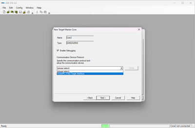

Continuing the above discussion, we are trying to flash the firmware through USB using UDE STK 5.2 software. But the software says it can be flashed using a JTAG connector (no USB option in the software).
The communication between the Discovery Board and UDE Debugger software is not happening due to this issue.
If there is no option to flash the firmware using USB, do we have to purchase SPC5-UDESTK? along with the license (UDE software)? and do we get the support from STM for this.
Regards,
Suvo
2024-05-02 1:00 AM
We never get this window. I guess you are manually trying to create a configuration and for PowerPC the only official way is the JTAG.
The only limit with PLS UDE free license is the code size of 256K. After this size you need to purchase a licensed debugger/programmer. The support of the PLS tool remains in PLS hands, we do not own the software.
In theory, if you try to open the right file from AutoDevKit Studio, you should not get this kind of window as the configuration is contained in the '.wsx' symbol file.
In PLS UDE just perform File>Open and select from the right folder your project with '.wsx' extension file. The default name is 'debug.wsx'. This file is generated from AutoDevKit Studio after generating and compiling the code and it is present in the UDE folder of the project. This file contains the configuration of the MCU and points to the out.hex of the project.
