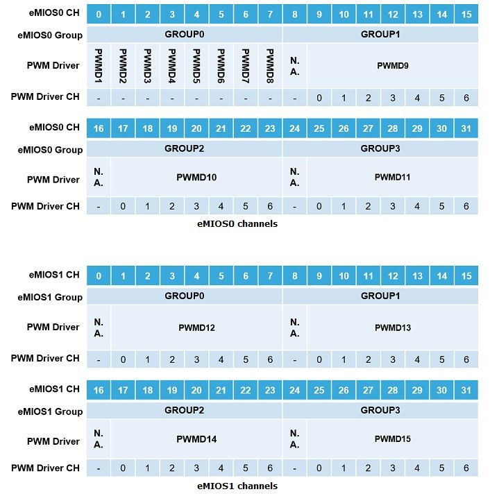

zambrano.luigi
as specified in the User Manual within the folder doc of the Low Level Driver Component, between the eMIOS channels and the driver instances there is the relationship summarized in the following picture:
0693W000007ZiakQAC.jpgAs you can see from the picture, the channel eMIOS0_UC8 is not available. This because, except for the first eMIOS group (eMIOS0 group0), the first channel of each group is used as counter for the other channels of the same group. So, for example, the channel eMIOS0 ch8 is the counter for the channels eMIO0 ch9-ch15. These channels (eMIO0 ch9-15) are managed as a unique driver (PWMD9) with 7 channels (0-6) with the same period. If you need to use the eMIO0_CH8, the driver must be modified.
Regards,
Luigi
SMay
Associate II
Thanks for your reply. Like I said, as a fallback I'd be ok with using eMIOS1_10, which is the same pin. According to the spec, that would make it PWMD13, channel 1.
So I configured it to UC10_1 in the pinmap editor, called:
pwm_lld_start(&PWMD5, &pwm_config_BR0_PWM);
pwm_lld_start(&PWMD13,&pwm_config_BR1_PWM);
And afterwards
pwm_lld_enable_channel(&PWMD5, 0, PWM_PERCENTAGE_TO_WIDTH(&PWMD5, 5000), 0, 0, 0);
pwm_lld_enable_channel(&PWMD13, 0, PWM_PERCENTAGE_TO_WIDTH(&PWMD13,5000), 0, 0, 0);
The call for PWMD5 works, I get a PWM at pin6. The configs are identical, ~39kHz PWM frequency and set to the respective eMIOS group & channel.
Where should I look for errors?
