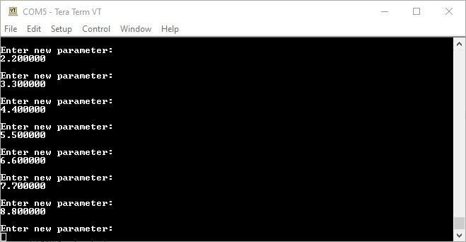

I have developed a simple application for SPC584B-DIS (different board, but same serial drivers and same RuntimeIO plugin) and the code works as expected.
* Application entry point.
int main(void) {
float echo = 0.0;
/* Initialization of all the imported components in the order specified in
the application wizard. The function is generated automatically.*/
componentsInit();
/* Enable Interrupts */
irqIsrEnable();
/* Application main loop.*/
for ( ; ; ) {
printf("Enter new parameter:\r\n");
scanf("%f", &echo);
printf("%f\r\n\r\n", echo);
pal_lld_togglepad(PORT_E, LED_4);
pal_lld_togglepad(PORT_A, LED_3);
pal_lld_togglepad(PORT_D, LED_5);
}In particular, if the comma is used to separate the integer part to the decimal part when the float is inserted, the output is correct as you can verify from the following image.

2021-02-25 11:34 PM
int main(void) {
float echo = 0.0;
componentsInit();
irqIsrEnable();
for ( ; ; ) {
scanf("%f", &echo);

2021-03-03 2:02 AM
Thank you very much Luigi it works now !
