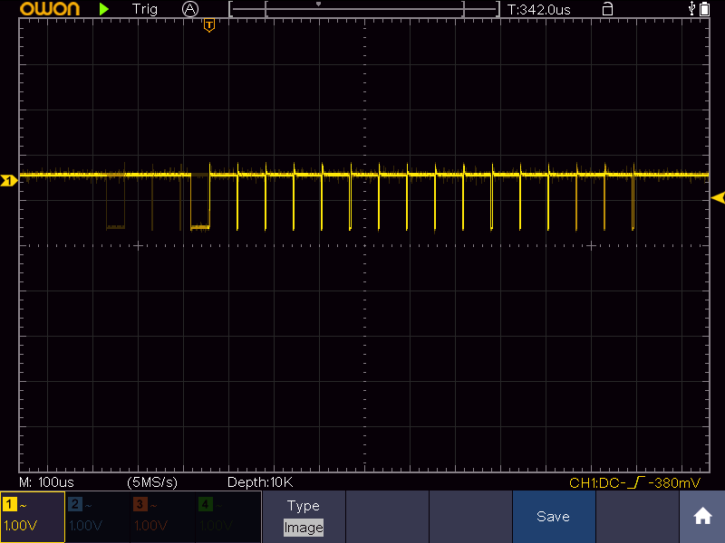

0693W000006GPy2QAG.bmpI'm currently trying to transmit the CAN frames using SPC570S-DISP.
I applied it to the SPC570S-DISP using only the example source code.
However, the CAN TX signal is output as shown in the picture above.

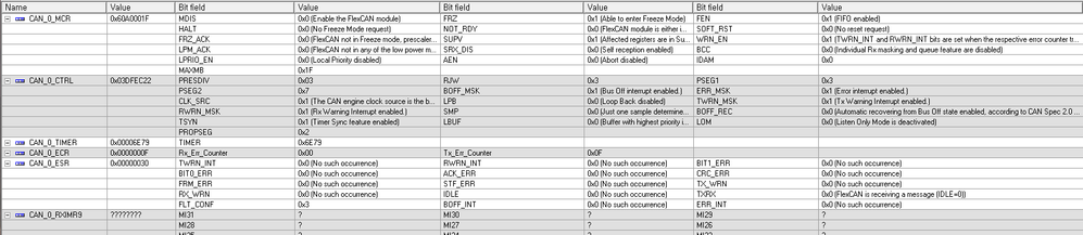

0693W000006GYKpQAO.pngUpper the picture is the peripheral Register set value.
FLT_CONF is setting Bus off status and to be generating the Tx_Error_Counter.
I think the Can Test Application source code seems to have a problem.

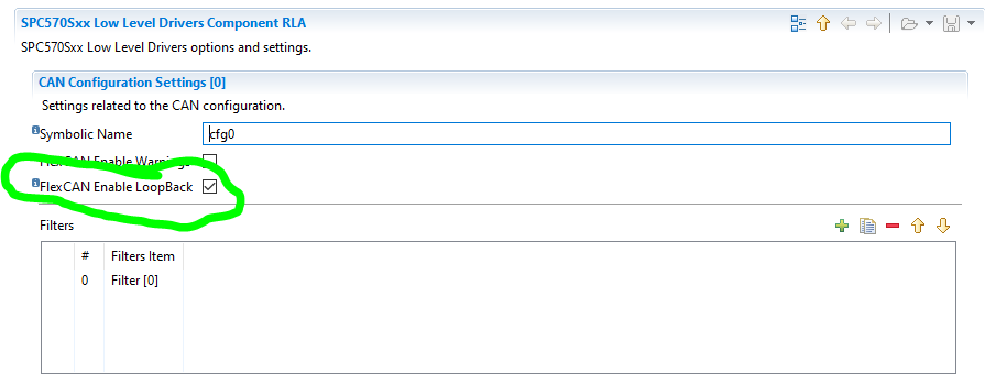

0693W000007Anj0QAC.png0693W000007AnkBQAS.pngHello ,
SPC570S CAN demo configures the CAN in loopback mode. So, there is n output.
In order to enable output, loopback configuration flag has not to be checked. See attached pictures.

I modified. but it's the same result.
if the loopback check box is enabled or the external pin is not set then the signal is not generated.
I don't know the reason for what is a strange signal.
