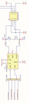

I've got the CAN Test app loaded and working as it should. I'm trying to get it to transmit out instead of loopback. I've already uncheck the option for loopback and simplified the code to only transmit. However, I don't see any activity on the CAN pins of the board. I've tried moving the jumpers from CAN0 to CAN1 and I've tried looking at the signal before the transceiver but still nothing. My code is attached below. Any help would be greatly appreciated!

But since you've disabled the looback mode (I suppose you intend to use the transceiver, you need another CAN node connected to establish a complete CAN bus. CAN is not SPI or UART. The sender needs to receive an ACK dominent bit from the receiver to complete the acknowledgement mechanism.
Thanks for your reply. I do intend on using the transceiver. I have a PEAK CAN device that sends ACK bits. I had that device hooked up to see if I would see any messages but no messages were picked up. The jumper for the 120 ohm termination resistor is connected. I also tried using an oscilloscope to check for any activity both before and after the transceiver with no luck. I'm wondering if there is something else beyond just disabling loopback mode that I need to change.
Check if the transceiver is not in the standby mode.
Looking through the reference manual, I don't see anything regarding Standby mode of the transceiver.
Is that the part of the hardware you are using?
Yes, that is. I have tried connecting a scope to B1 and B0 to check for a signal before the transceiver. At start of program, all it does is jump to 5V and stay there. Do you know of any sample code that includes Normal mode CAN examples? I can only find Loopback CAN sample code.
