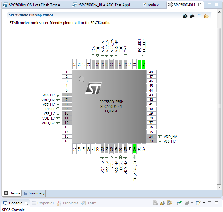

Have you configured correctly your pinmap Wizard ?
Did you arrive to End Of Conversion Interrupt ?

Warning : for Standard channel , we should PSAMP to 50

Somehow I forgot the Pinmap Wizard again, now it is works as expected.
