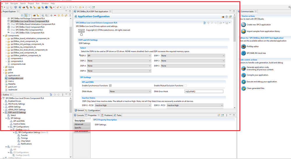

2021-02-03 8:58 PM
We are using the Same as you suggest one only(SPC studio 6.0)
In that we doesn't have the Driver layer for the L6230 driver code
I dosen't know what are the MCTK Features/plugins for SPC5Studio.
Please explain this for us to understand this deeply and moving forward..
Thanking for reply
Saravanan Mariyappan
