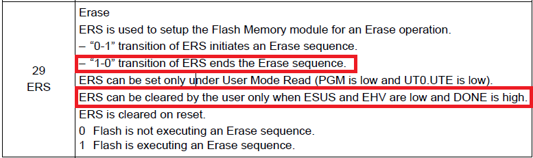

Could you check if you respect the transition ?
Have you unlocked the flash ?
