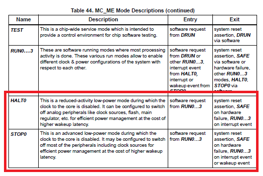

The sleep mode option in SPC560P-DISP Discovery (SPC560 P Line) is removed as per reference document. I have attached the revision history screenshot of reference document.
My question is
please see the image for reference

Yes , there is low power mode option
cd Table 44 in Screenshot
