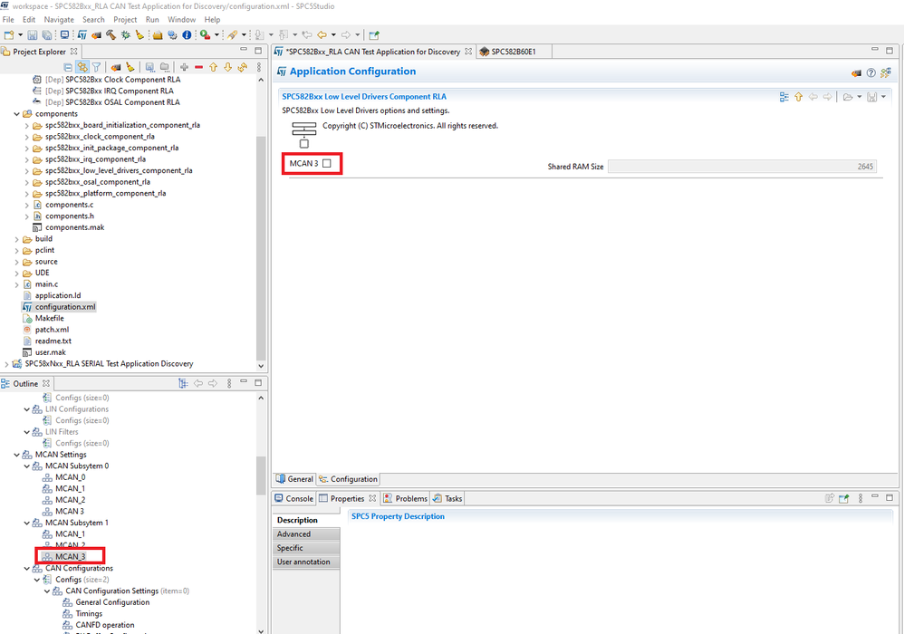

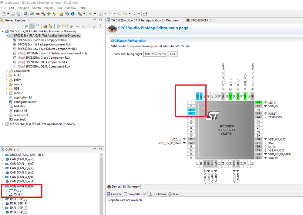

Hello ,
You can configure your CAN_6 by using the Pinmap
I think that CAN_6 is configurable from MCAN3 Subsystem 1
cf screenshot
Best regards
Erwan

2023-05-24 3:30 AM
Dear Erwan,
Thank you for the help. I have already done this part and now I'm stuck at the CAN test code. When I test the internal loopback code it's working as the reference manual. But when I try the CAN_2 and CAN_6, CAN_2 is working (receiving and transmitting) finely with the uC pin 52 and 53 with FIFO0 (as the CAN test code). When when I change the rxreceive function (void mcanconf1_rxreceive(uint32_t msgbuf, CANRxFrame crfp)) to the CAN_6 it does not work with the PF2 and PF3 pins in the board. CAN_6 does not give me any CAN frames. But CAN_2 does. I put 250 Kbps as the speed and gave a standard CAN ID and data. Hope you can help me with that.

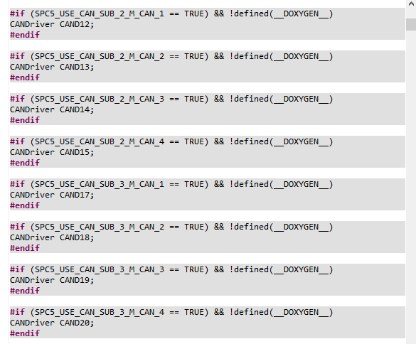

2023-05-24 4:55 AM - edited 2023-11-20 4:49 AM
Can you also tell me how to enable the following CAND10-CAND20 in the can_lld.c?
