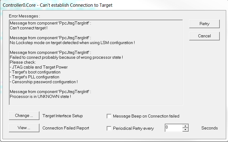

we use the SPC56EL70 discovery board with Spc5 studio as IDE and UDE STK - 4.8 as Debugger.
Today we got the following failure message - please see the following picture.
The only thing we changed was the additional usage of the A/D-port E12. After downloading the extended code we got the above failure message. Now we can�t flash the SPC with another source code.
Please let us know how we can put the SPC back into operation.
Thanks in advance. #processor-in-unknown-stateSolved! Go to Solution.

you can try the following: Interface Setup -> Connect and choose under connect: Keep application running.

Hi ,
Yes , in LSM (Lock Step Mode) , you should update your debug configuration
2018-01-09 7:15 AM
Hi Erwan,
how can I update the debug configuration respectively which settings do you mean?
