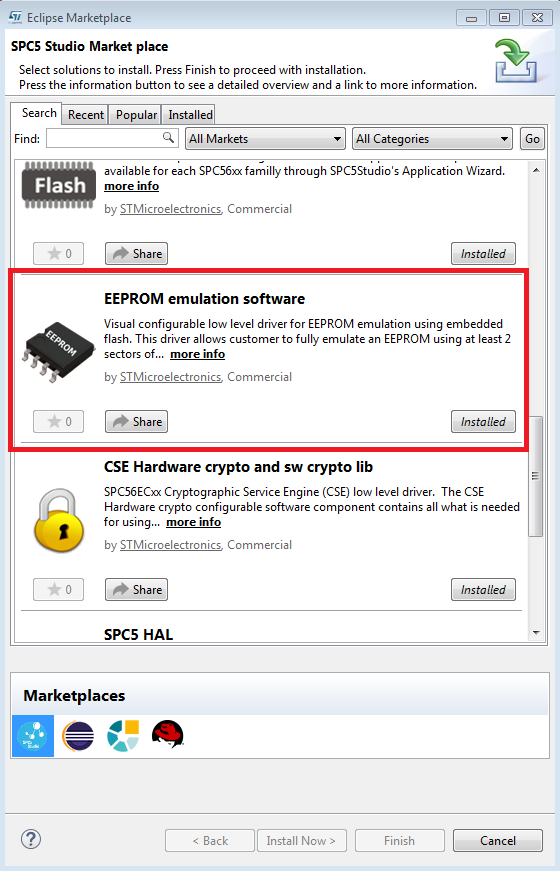

2017-12-06 12:44 AM
Hello Daniel ,
Did you try EEPROM Emulation Software coming from SPC5Studio Marketplace ?
There are some examples in Application repository example.
Best regards
Erwan
2018-01-08 3:11 AM
Hello Erwan,
I was out of office for a while and found now your reply.
Thanks for your suggestion, sounds very good! Actually I didn't consider to check in market place for additional drivers, this seems to be what I was looking for.
Thanks a lot for your help.
