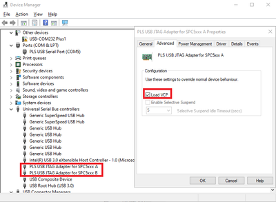

to enable VCP you should enable it on device manager cf screenshot
if PLS USB Jtag is not present, maybe your board is ko or in reset escalation.

Hello Rosen ,
Cf Screenshots Attached
In device manager,
1) Check if PLS USB JTAG Adapter for SPC5XXX A / B is well present
If not , reinstall from thec:\Program Files (x86)\pls\UDE 4.2\Driver\
2) From Drivers Properties , Load VCP (Virtual Com Port)
3) Unplug USB cable and replug USB Cable
4) In Device Manager, You should see PLS USB Serial Port (COMX/COMY)
I have checked on Windows 8. it is working well.
Best regards
Erwan

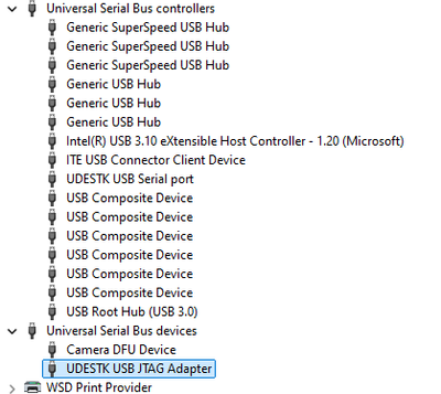

When I connect EVAL board through mini usb port, device manger shows USB serial port & not PLS USB/JTAG adapter
Please suggest solution.

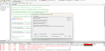

Message from component 'PpcJtagTargIntf' :
Can't connect target !
Failed to open communication channel !
Message from component 'FtdiCommDev' :
Failed to open FTDI device driver !
Message from component 'UDEDebugServer' :
Unable to establish connection . To correct the situation, check configuration file entries and try again.
I am using Windows 11 with UDESTK 5.02.04 Build 8310 version for my SPC560P50. I even enabled Load VCP and tried, but still the board is not connecting. I did verify all the pins on the board and the JTAG connector.
I did reinstall the drivers as well.
