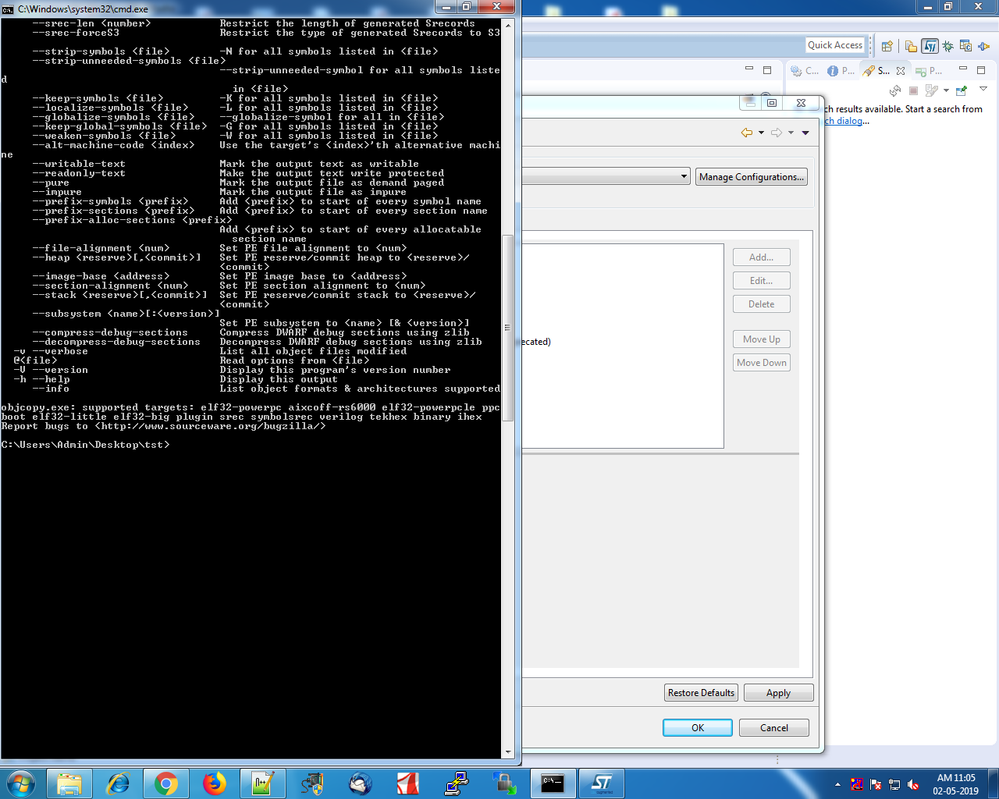

i have spc5668g powerpc core.and here is snapshot of objcopy -h but i dont know which one is used by spc studio to generate .elf
2019-05-01 11:47 PM
Try doing "objdump.exe -a" or "objdump.exe --archive-headers" (might be ""objdump.exe /a", ""objdump.exe /archive-headers" on Windows) and see if the file format it reports matches any of the ones reported by "objcopy --help".
