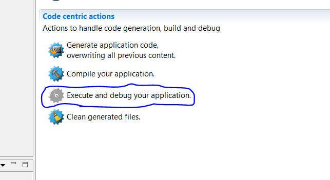

2020-10-03 11:12 AM
Execute and debug your application is not active

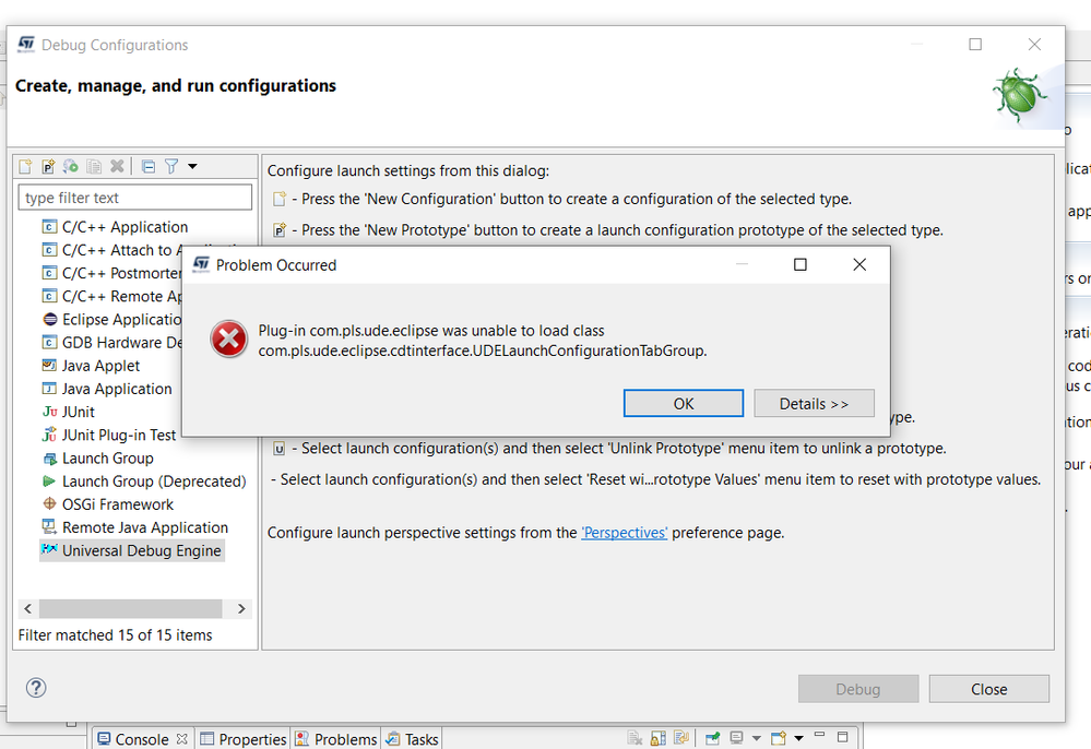

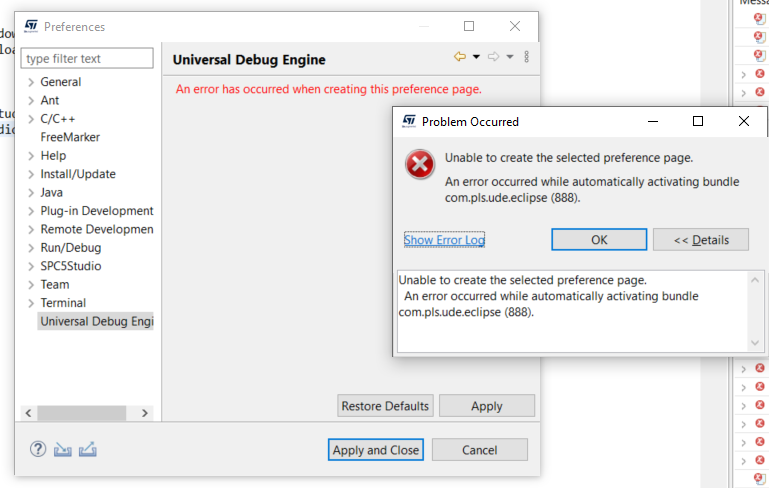

2020-10-03 3:38 PM
I am having same issues..
I also tried below method:
After bundle of software updates... Then it managed to install version 2.8 UDESTK...
However, another error...

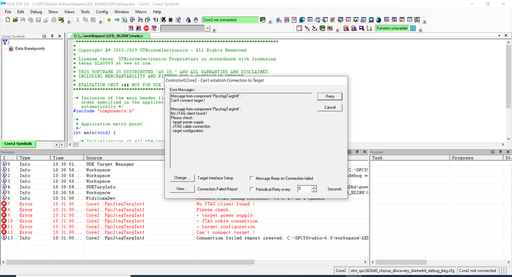

2020-10-03 10:09 PM
hi,
@x7yu
I downloaded the UDE 5 EVAL from https://www.pls-mc.com/service/downloads/download-spc5-udestk/
I am trying to flash a simple led blink firmware
I tried to open debug.wsx
I am using AEK-MCU-C1MLIT1 development board.
Is there any setting we need to do in the SPC5 IDE
2020-10-16 12:09 AM
@VLELE.1
When you loaded the debugging file, it will show below windows to link up, then click ok. you should have your debugger works.
Actually I prefer to work on the debugger mode in SPC5 Studio, however I'm not managed to enable the button. If you success to do so?
