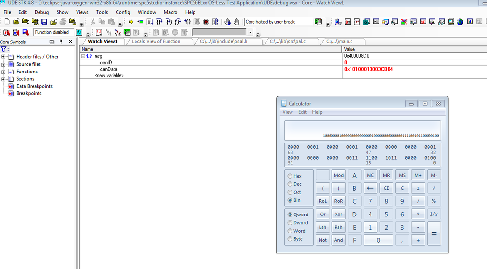

Posted on October 12, 2017 at 15:55
Hello ,
after checking the 64 bits issue ,
No problem is noticed
(Cf Screenshot)
typedef struct
uint16_t no;
uint8_t duration;
uint16_t buzzerSong;
uint16_t priority;
}event;
typedef struct
uint32_t canID;
uint64_t canData;
}canMSG;
typedef enum
PRIORITY_BLOCKER = 0,
PRIORITY_HIGH,
PRIORITY_MID,
PRIORITY_LOW,
PRIORITY_TRIVIAL
}priorityLevels;
event eventRecord = {0,0,1,255,0,0};
canMSG msg;
uint32_t no=1;
uint32_t duration = 1;
uint32_t priority = 1;
msg.canData = (0x04) + (971uLL << 8) + (((uint64_t)no) << 32) + (((uint64_t)duration) << 48) + (((uint64_t)priority) << 56);
Best regards
