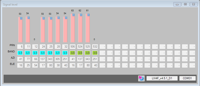

the teseo picture before the update :
With new firmware, bagraph doesn't work.
Also, I have test have using $PSTMRF frame but doesn't like to work too.
Can i have acces to old firmware for my test ?
Can i have a release note for the firmware ?
or a config register whith new firmware who response to my need ?
