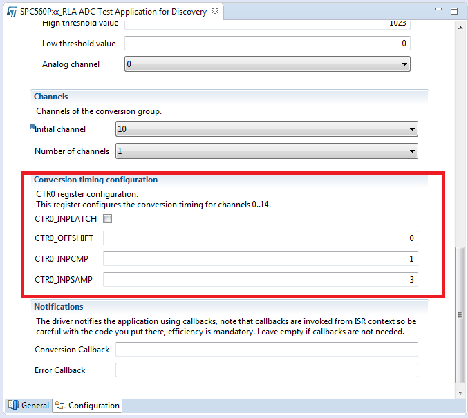

I'm using XPC56xL minimodule on the XPC56XX motherboard.I slightly modified the SPC56ELxx OS-Less ADC Test Application to print the ADC conversion values on the UARTThe issue I noticed is that the value of the conversion is not stable: for example if I print 15 measures (all of them done without changing the trimmer position) I get the following result (in hexadecimal):ADC Value:
278279274278277274272272275278276274276276278276So it seems that the 4 least significant bits are given only by the noise. Since i read on the reference manual that the ADC has 12 bits resolution, i would like to know if there is a strategy to keep those bits stable.
Thank you in advance!kind regards,FabioSolved! Go to Solution.

For a normal conversion , you have to increase PSAMP it is more stable.
Could you increase it ?
Sorry, The RM is not accurate for this point.
Best regards

Thank you for your help but the situation hasn't changed: i tried several values for PSAMP (also the maximum) but those 4 LSB are still unstable.The value should be stable, because it simply depends on the value of the trimmer resistance.
Do you have any further suggestion?
Thank you in advance for your support!
Kind regards,
Fabio
