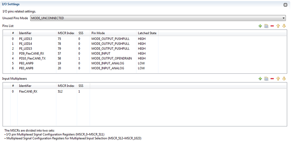

Modified Pin Settings:

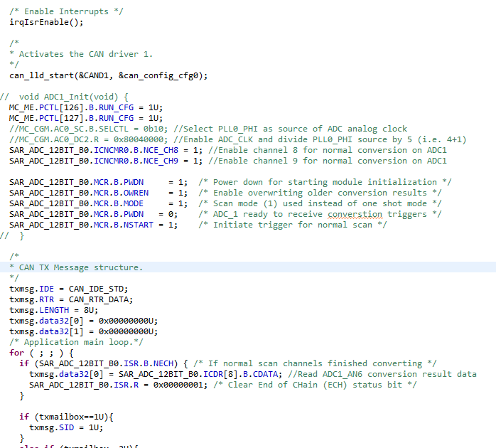

in main.c I tried to initialize and use the ADC:
Without ADC-code CAN example works fine.

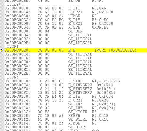

But if I try to get Access to the ADC-regs, System crashes:
The system always stays at the _IVOR1 after SAR_ADC_12BIT_B0.xxxxx = x command.

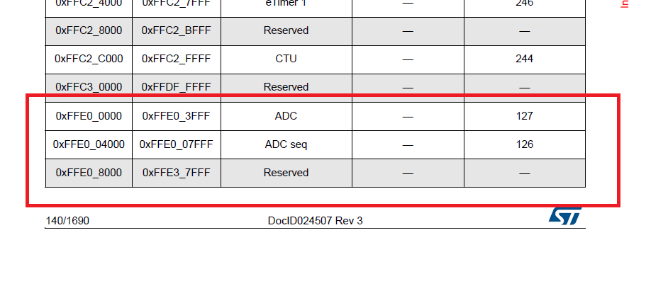

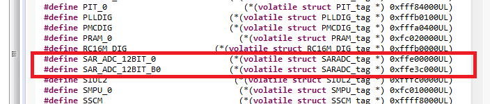

the address 0xFFE3c000 is RESERVED and IVOR1 logical according the RM.
Could you replace SAR_ADC_12BIT_B0 by SAR_ADC_12BIT_0 (cf xpc570s.h)?
Anyway , i am submitting an ER for this inconsistent header file.

Sorry , i was on a bad revision of the reference manual not the last one (Revision 6 RM0349)
Table 12 was not correct on rev 3.

here is the answer.
'The problem is not related to wrong address of the supervisor ADC (
SAR_ADC_12BIT_B0
), but It is related to clock gating.
Every time a driver is start (xxx_lld_start) the correct PTCL register is written in order to gate the clock to the peripherals. When using a driver not included in spc5studio
The first operation to do before accessing register is to gate the clock using the function, otherwise IVOR1 is generated.
SPCSetPeripheralClockMode(PCTL NUMBER, (SPC5_ME_PCTL_RUN(2) | SPC5_ME_PCTL_LP(2)));
In this case the PCTL NUMBER for
SAR_ADC_12BIT_B0
is 112 (table 658 in the RM).'
