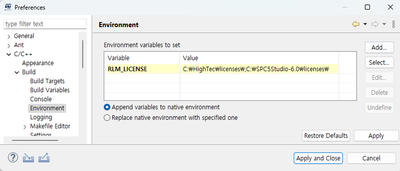

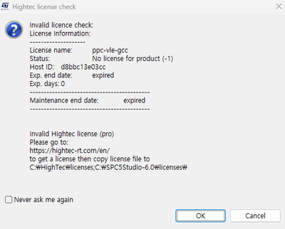

Hello, I am currently developing with SPC5Studio 6.0.0.
In my project, I need the HighTec Pro option, so I downloaded the license and tool chain files from http://register.hightec-rt.com/st/spc5x.

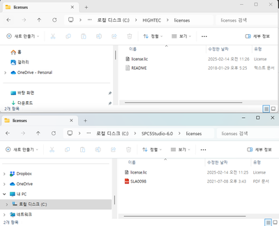

I placed the license file in both:
- C:\SPC5Studio-6.0\licenses
- C:\HIGHTEC\licenses
However, it still says that no valid license can be found.
How can I resolve this issue?
Best regards.

Hello ,
the link  http://register.hightec-rt.com/st/spc5x is not for Hightec Pro license.
it is only for Higtec Free license
HighTec Free Power Architecture
You should copy in c:\SPC5Studio-6.0\licenses
we do not provide the pro license
we should use an other stream
License Activation :: HighTec|DOCS
   Best regards
                 Erwan
