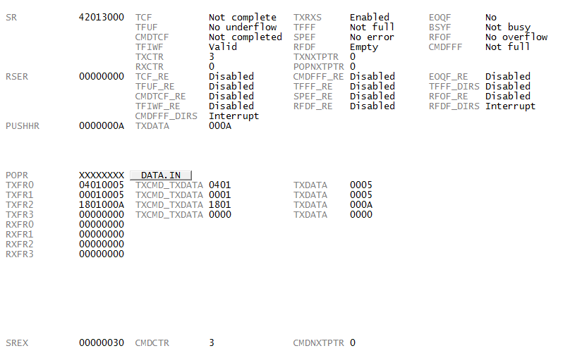

Hello, I would like to know what is wrong with my current configuration of SPI module. I can see data in the TX FIFO, but its not getting transmitted.

Figured out what the problem was. I didn't realize I had it configured as a slave device.
