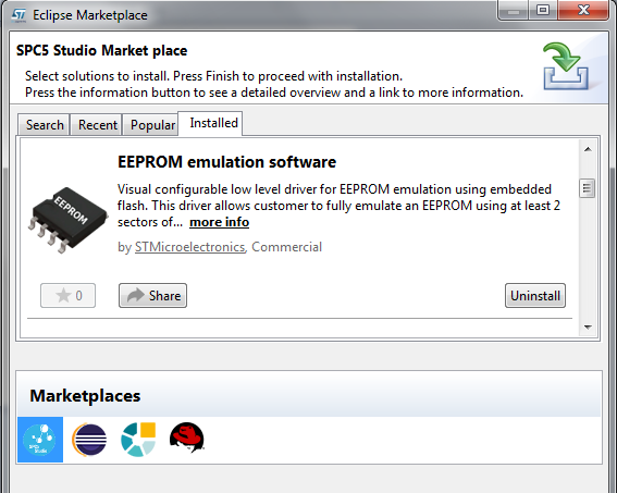

I am using SPC560B540L5 Discovery board and SPC stdutio 5.2.3 updated version code generator.

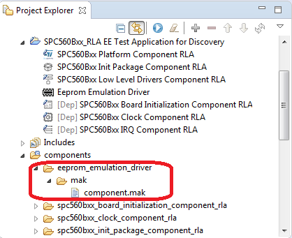

I am trying to emulate the Flash as EEPROM using EED driver. The IDE is installed with EEPROM emulation software and the way I generate the project is also proper even then the necessary configuration files and libraries for EED are not getting generated after generating the code. Normally, it should get listed under the EEPROM Emulation driver in components directory, but nothing exists other than ''mak'' folder. Please find the snap below.
But still I tried to build the project but the compilation failed due to below shown error.

2017-03-13 3:22 AM
Hello R. SanthaMurphty ,
The problem has been reproduced on 5.2.3
it will be solvedofficially on 5.3.0.
Anyway, you can install these new eeprom feature by local update
(Uncheck Category)
it solves the issue
Best regards
Erwan

2017-03-16 11:33 PM
Hi Erwan,
Thank you very much for providing the plugins related to EED. I done with the local update and the EED sources are getting generated now.
EED test code for SPC560B- Discovery RLA is working as described in ''readme'' file.
