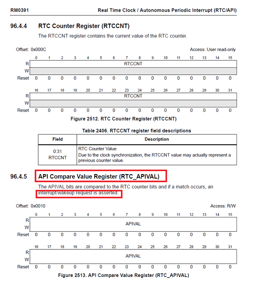

2017-10-25 4:52 AM
Yes, with RTC you can put 5 hours you have just find the good Compare Value register
(RTC_APIVAL)

I gone through the RTC chapter. By using set of registers in RTC we can achieve this.

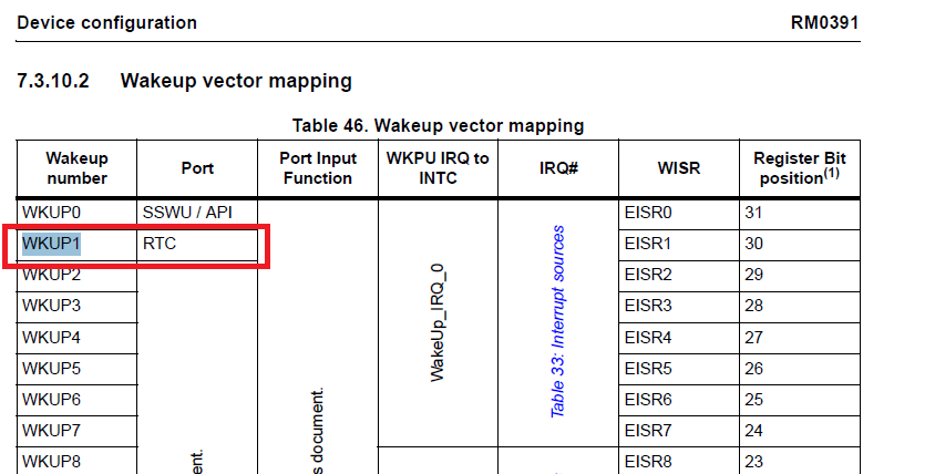

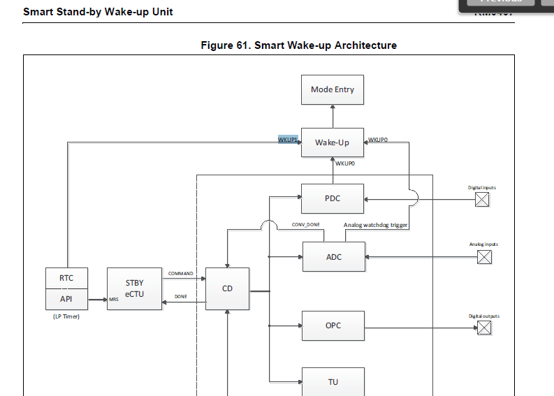

3. Is there link between RTC and SSWU? After 5 hours system needs to wakeup according to this RTC interrupt will trigger SSWU for system wakeup? I have attached the image which shows the relation.

Hello Shiva ,
After checking the RM , there is no PCTL associated on SPC58 Family
I think that RTC is not switched off in Low Power Mode. (STANDBY or STOP mode)
