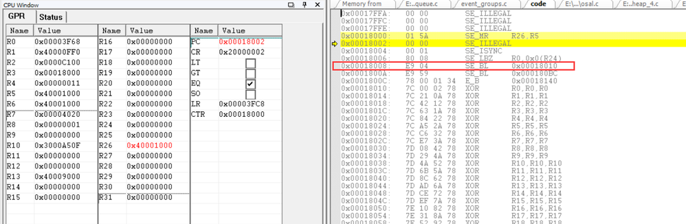

My APP address is 0x18000, i did test.
if i wrote:
e_lis% r3, HI (0x00018000)
e_or2i% r3, LO (0x00018000)
mtctr% r3
se_bctrl
Jump failed.
I must write:
e_lis% r3, HI (0x00018008)
e_or2i% r3, LO (0x00018008)
mtctr% r3
se_bctrl
Jump success, MCU can be executed to the APP main function, but the implementation of abnormal ....
Please tell me, before jumping program, how should I do?
