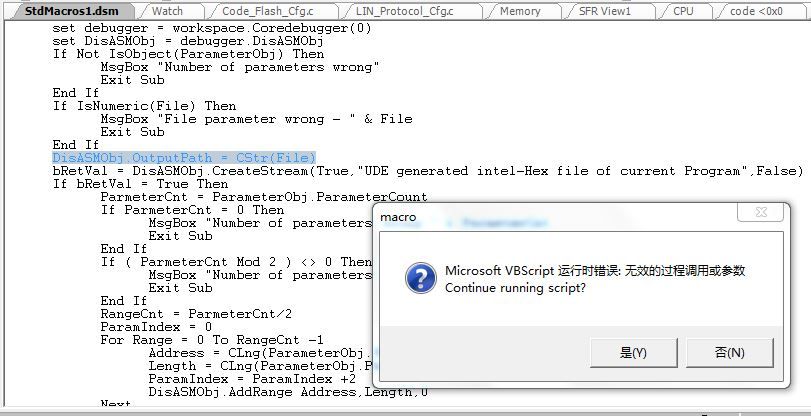

Posted on October 27, 2017 at 04:13
I do it like this: Application.hex 0x0,0x8000
and I got the following error.
Erwan YVIN
Posted on October 27, 2017 at 10:39
Hello Zhang ,
You have to run the script
there is a button to do that
and check the Windows directory
      Best regards
                Erwan

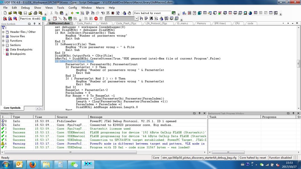

Yes, I'm the administrator of my PC and I can install some software in my PC. I enter ''Application.hex,0x0,0x8000'' and after the following it will go to the end.

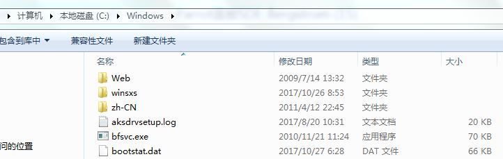

Posted on October 27, 2017 at 10:50
I use the following buttons and there is no Application.hex in the Windows directory.

Hello Zhang ,
No , You should run the macro script not the embedded software.
         Best regards
