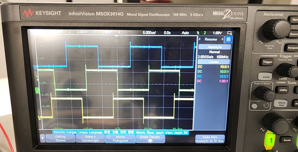

I'm working with SPC58 microcontrollers and configuring 6 PWM channels using different eMIOS. The PWM channels within the same eMIOS are properly synchronized, but the channels from a different eMIOS are not synchronized as expected.
I have attached a figure illustrating the issue. How can I configure the PWM channels from different eMIOS to ensure proper synchronization? Are there specific settings or registers I should adjust?
Any insights or recommendations would be greatly appreciated.
Thank you in advance!
