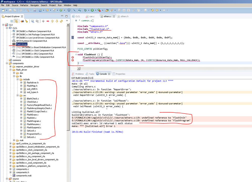

I am trying to include Flash Driver component into my project of SPC560B50L1.
I have added it from available components and it appeared in project as shown on attached screenshot.
Then I wrote simple procedure, but linker says that flash driver's functions references are undefined (on attached screenshot).
Is there something more I need to do in order to use flash driver's functions?

2019-12-23 1:55 AM
Look carefully at the log - those are linker errors and indicate that function implementation (not declaration) can't be found.
2019-12-23 2:07 AM
Yes, I know it is linker error.
The point is, that I use embedded components. Since this is not my code, I expect to follow the procedure and be able to use the driver's functions (compile, link, put into UC, run). Yet I can't. It is a matter of environment, which is quite new for me.
Moreover, source files attached to the project do not contain code, but binary tables (and header files). So I cannot simply cut some code and create own driver...
2019-12-23 5:32 AM
The functions must be either as a source code in *.c files or in a precompiled libraries, which then must be linked.

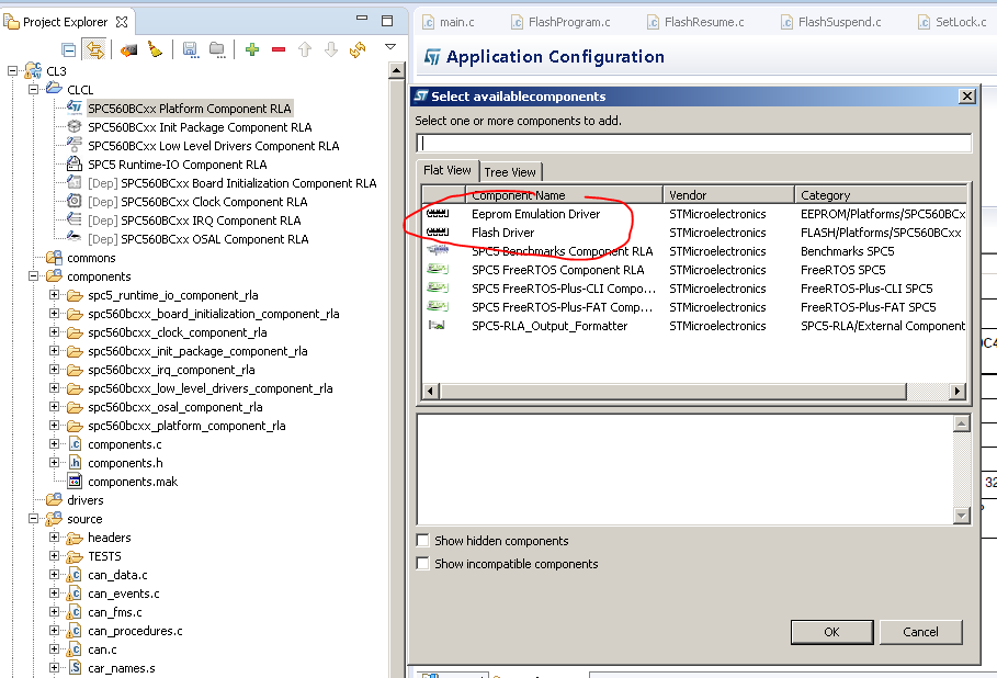

I have just discovered another related issue: is it intended, that I can use only one from Eeprom Emulation Driver and FlashDriver in my project?
Until I don't use any of them in my project - I can include both:

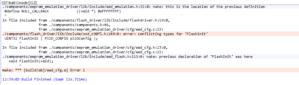

But, when I include both - there is a conflict, because both drivers have function FlashInit(). Compiler reports it as error:

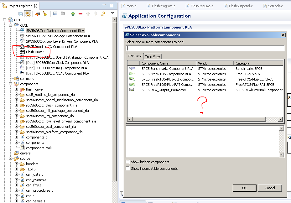

Moreover, if I already have one of these drivers in my project - the second one dissapears from the list of available components (yet, it can be found in "incompatible components"):
I think I could rename one function, but I wonder if these drives don't share the same CPU's resources (so they cannot be used together, indeed?).
2020-02-07 6:40 AM
Hello Yannek ,
Sorry, We have not checked the coexistenz of EEprom and Flash Component in the same test application.
you can try to update ssd_c90fl.h by adding a preprocessing in order not to redefine FlashInit.
We are using the same Flash Driver mecanism
I am submitting a CR .. you have not the only customer to request this functionality.
