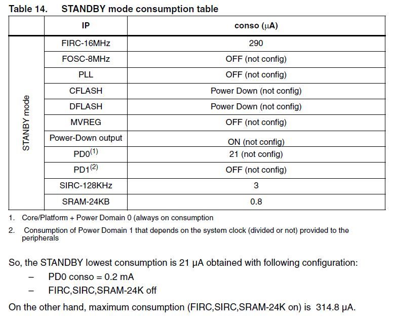

I am trying to make SPC560B54L5 EVB in low power mode that is STANDBY mode.
The measured current in normal RUN0 mode is 143 mA whereas while keeping in STANDBY mode, it is around 92 mA. But as per the AN3316 Application note the max current consumption is 314uA. So am I entering into STANDBY mode correctly?

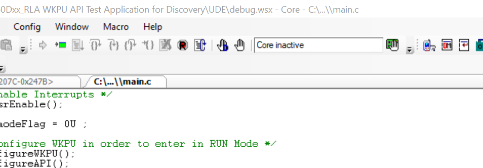

SPC560Dxx_RLA WKPU API Test Application for Discovery
The core should display Core Inactive on a debug session
