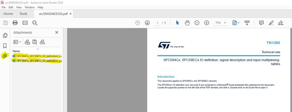

if you download the PDF file TN1260 - SPC584Cx, SPC58ECx IO definition: signal description and input multiplexing tables from this link, you can find in attachment a couple of files xlsx containing all the information needed for the pin configurations of your device.
Regards,
Luigi

Dear Luigi,
This attachment is not found in the pdf file. Can you please help on this.
cannot able to locate the paper clip symbol as per the instruction on the document.
Regards
Bipin.
2021-05-26 1:57 AM
Hi Bipin,
please, see the following picture
Regards,
Luigi
2021-05-26 2:10 AM
Dear Luigi,
Thank you so much for the help. That was an issue with PDF Reader version.
