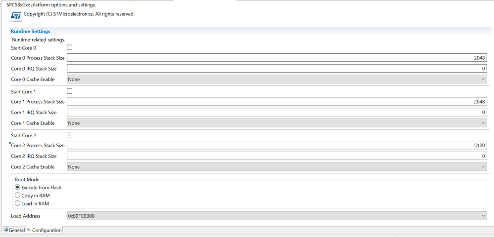

Would you please show me your BOOT configuration in SPC58xGxx RLA Platform->runtime_settings ?
as example:
BRs,
-Olivier
2022-01-28 5:41 AM
Hi Olivier,

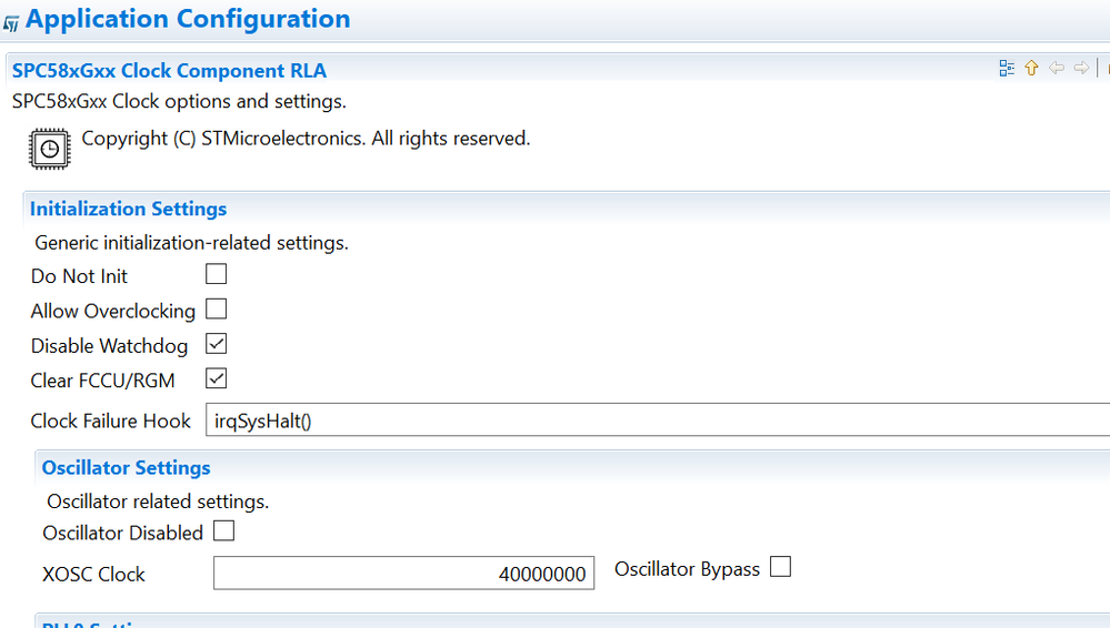

Here's the Platform RLA configuration (I dont have watchdog option in this)-
Watchdog is in clock RLA -
Warm Regards,
AM
2022-01-28 6:13 AM
Could you try this Load in RAM configuration ? (in runtime settings)
BRs,
-Olivier
2022-01-28 6:28 AM
Hi Olivier,
Great! This is erasing the flash successfully, even writing to flash is also working.
Could you tell me the reason for this?
Warm Regards,
AM
2022-01-28 6:32 AM
I am not 100% sure, I will check with Flash expert,
but I think you cannot erase a flash sector near to the one you are executing your own program.
0xFC_0000 and 0xFF_0000 are may be too closed from each other.
Load your program in RAM and executing from RAM, there is no more conflict
BRs,
